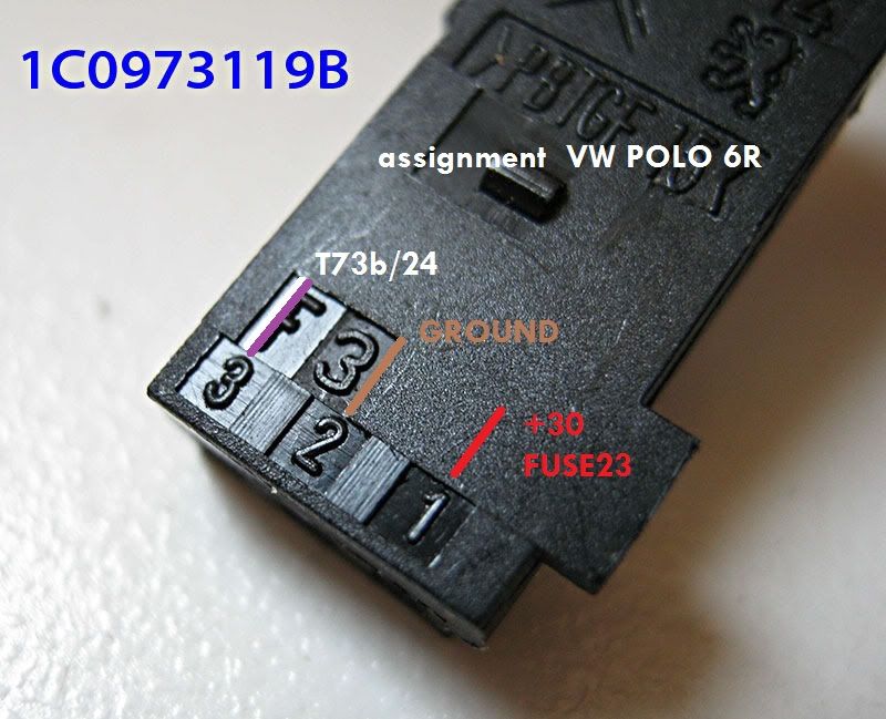

For dimming mirror and light/rain sensor there are several online tutorials (DIY retrofit) on another VW models, the links below are for Polo 6R. .
POLOVW.IT ? Leggi argomento - (Tutorial)Montaggio specchietto fotocromatico Polo 6R
Here you can buy all the OEM assembly.
http://www.aliexpress.com/item/OEM-...-Rearview-Mirror-For-VW-Tiguan/723426711.html

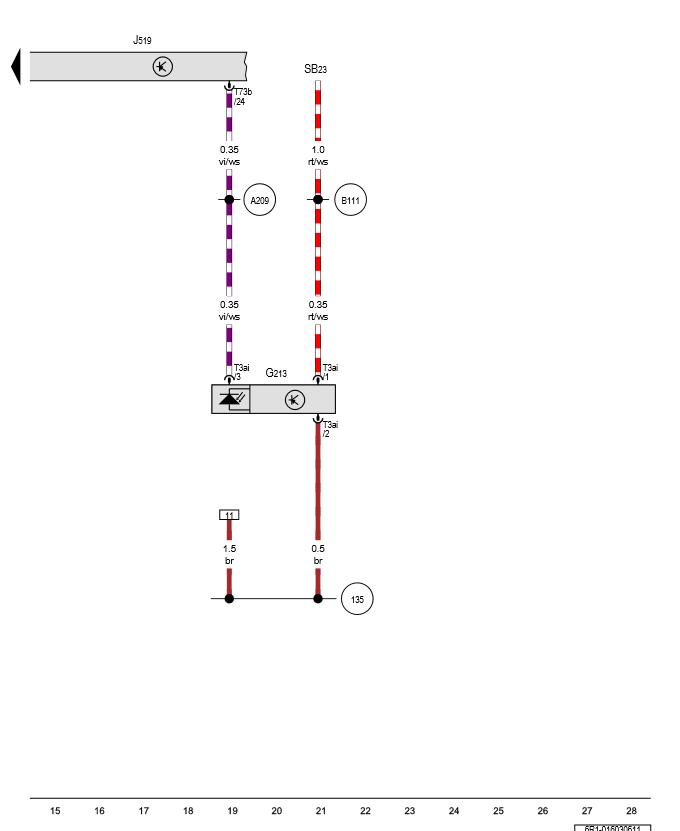

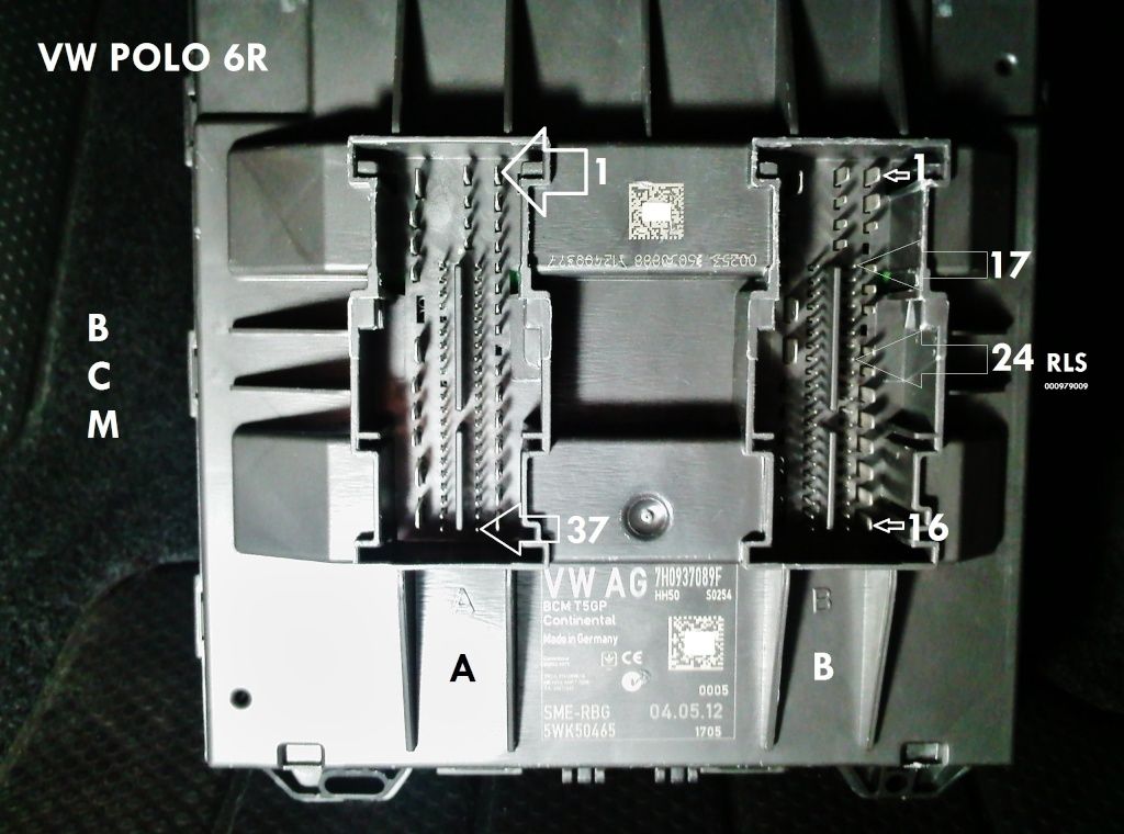

Schemes for Polo 6R.
UK-POLOS.NET ? View topic - VW POLO 6R. WIRING AUTO LIGHTS. Coming/leaving home. OEM.
Then you are ready to install wiring for automatic lights, coming / leaving home...:wink:
